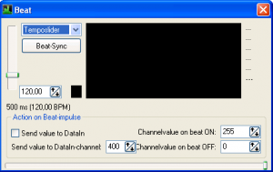

With the Beattool you can control PC_DIMMER from an external 'audio' signal.
With the FFT-option you have 32 frequency channels that can control up to 32 virtual channels First of all activate FFT from the function-drop down menu. Next, select the audio-card you will be using the input the audio signal into the Beattool. Next, select the input-channel from the audio-card (Line in, microphone, ....) There is no volume-control here, so the volume should be set by the windows-tool provided with your audio-card.
In the lowest block, you can then set the behaviour of the FFT-Beattool. First click on the frequency bar you want to use to control a certain function of your lichtfixture. Next, select which DataIn-channel must react on this Frequency-bar. Also select a multiplicator value. If these 3 parameters are selected, click on the 'Send values of this channel to DataIn' to activate it.
Example: Suppose you have an RGB-licht fixture. You want frequency bar nr3 to control the RED-intensity, frequency bar nr 15 to control BLUE-intensity and finally frequency bar 23 to control GREEN-intensity. Click on bar 3, select DataInchannel 1 and multiplicator 255 (values between 200-300 normally to work best) and activate it with 'Send values of this channel to DataIn' Repeat this for Bar 15, which you direct to DataIn channel 2 and bar 23 you redirect to DataIn channel 3.
Don't forget to go to the configuration of the DataIn Events. There, you have to softpatch the right channels. For the above example, make sure DataIn channel 1 is softpatched to the correct DMX-channel of the licht-fixture (E.g. 38 is the RED-DMX channel of the fixture), Also DataIn channel 2 and 3 must be correctly softpatched (e.g. 39 and 40)
