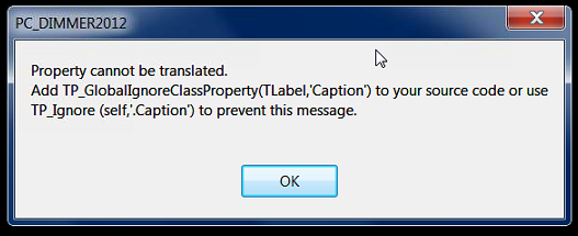

Second message, i'm not sure what it is complaining about. please have a look at the attached screenshot.
message 2
message 2
pcdimmer message 2.png (64.06 KiB) 14065 mal betrachtet

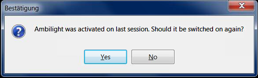

Third message is about the ambilight startup. Last session it was enabled, do you want to enable it again.
Can this message somehow be skipped in any case? I don't want to acknowledge this even if ambilight is on or off the last session.
message 3
message 3
pcdimmer message 3.png (62.58 KiB) 14064 mal betrachtet
