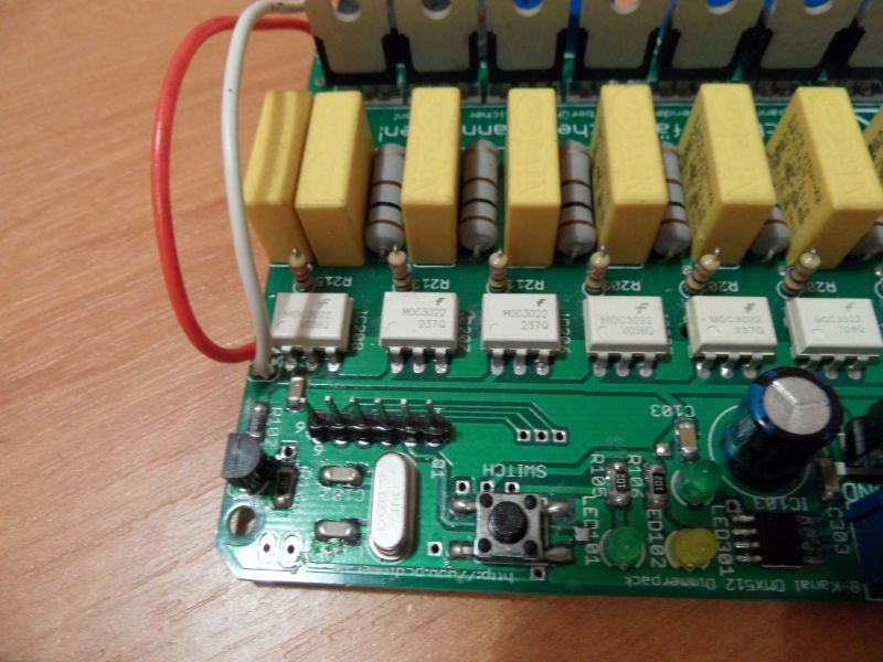

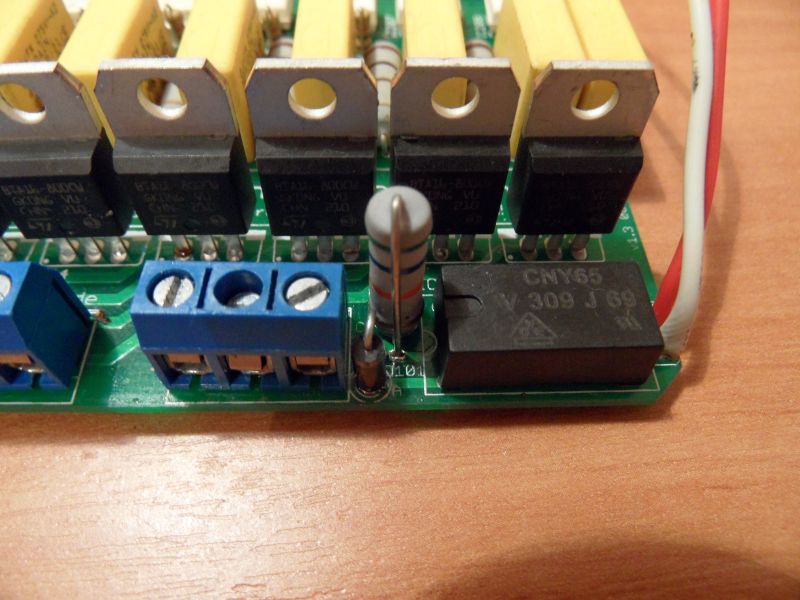

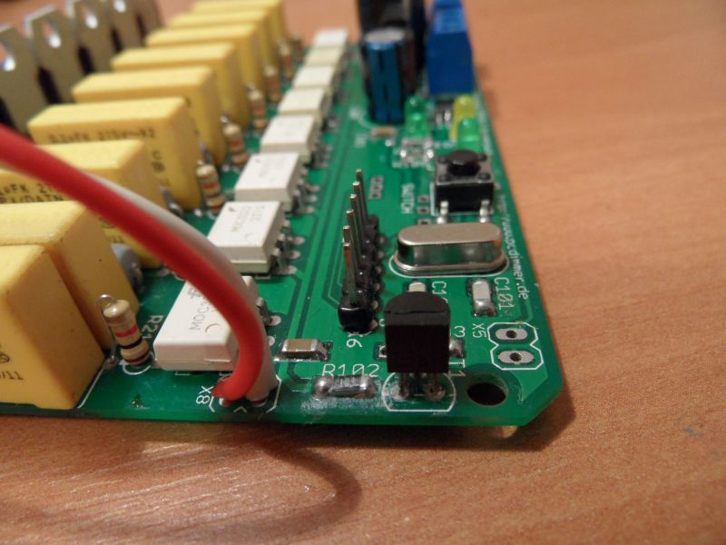

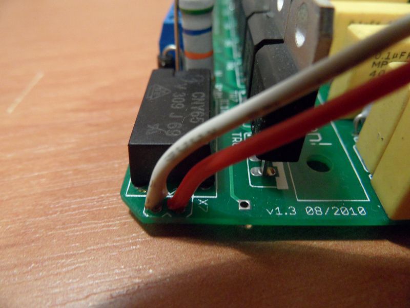

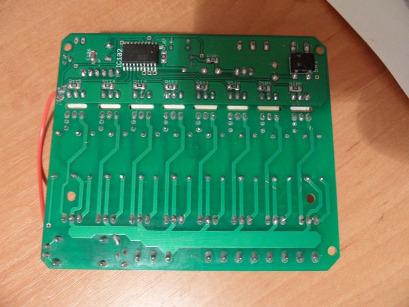

I will try in English, so it will probably clear. The boards I produced at the factory, version 1.3. About the mistake with the resistor R101 know she corrected. All items are strictly comply with the scheme. The capacitor C106 is 100pF.
Once again, I will describe the problem: When connecting to a network error occurs Zero-Crossing-Detetstion. but when I turn the plug into the socket (ie, changing the phase and zero in some places), as the board starts working normally.
Fork position in the socket matter?
- SAM_0332.JPG (103.76 KiB) 31239 mal betrachtet
- SAM_0331.JPG (100.68 KiB) 31238 mal betrachtet
- SAM_0329.JPG (101.03 KiB) 31238 mal betrachtet
- 02.jpg (84.76 KiB) 31250 mal betrachtet
- 01.jpg (112.23 KiB) 31250 mal betrachtet

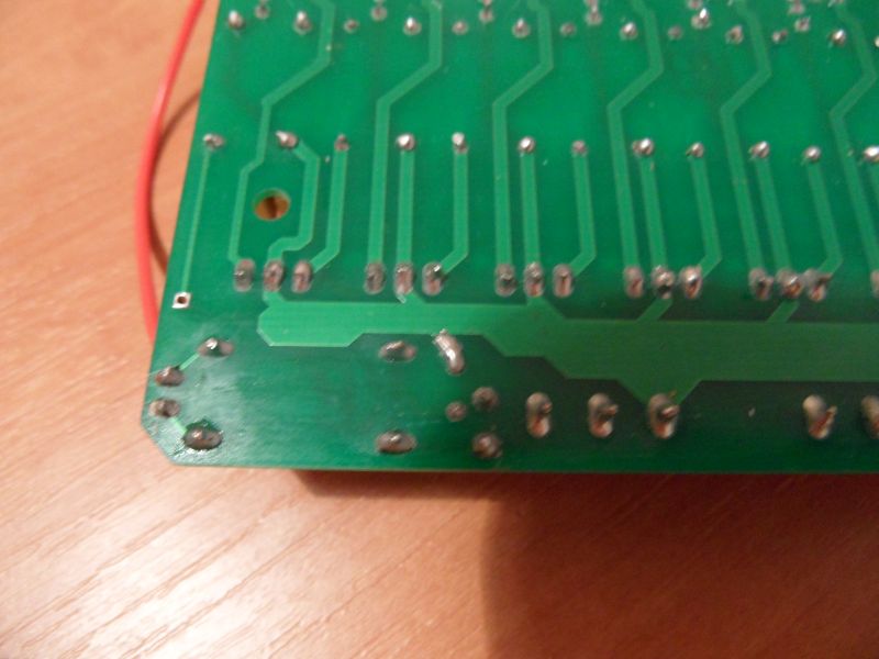

more
- SAM_0337.JPG (95.25 KiB) 31225 mal betrachtet
- SAM_0335.JPG (76.9 KiB) 31223 mal betrachtet
- SAM_0334.JPG (82.74 KiB) 31220 mal betrachtet
- SAM_0333.JPG (91.85 KiB) 31221 mal betrachtet
Re: das Problem mit dem Netzteil-Platine Dimmer
hmm, everything seems to be well soldered and you've corrected my mistake with R101.
Maybe there is a problem with the capacitor C106. Try without it or reduce its value. Sometimes a too high value of capacitance can disturb the Zero-Crossing-Signal. The 100pF are at the end of my recommended value. But anyway, I do not have an explanation, why this would have an effect on the order of the two 230V inputs.
